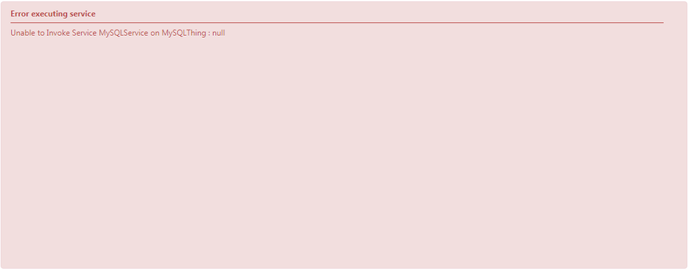

Hello! Perhaps there was already such a question, but still. A service of SQL-query type produces the following error when I try to test it:
There is a connection to the database itself, there is a data in it too. As I understand, the problem is that my service is perceived as empty. But I don't understand what could be wrong.

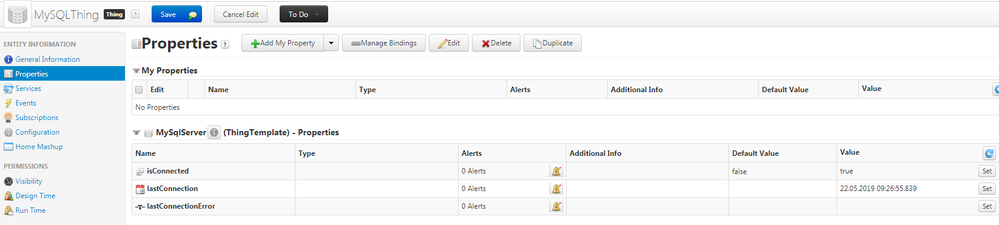

I took the configuration from MySQL Extension and changed the name of the database and address:
In properties I set the isConnected property to true:

Please refer to this page to change the connection string and the validation string accordingly:
http://support.ptc.com/help/thingworx_hc/thingworx_8_hc/en/#page/ThingWorx%2FHelp%2FExtensibility%2FJDBCExtension%2FJDBCConfigurationExamples.html%23
When you database is properly connected -- you should not be changing isConnected to true, it will set automatically -- in your service, click on tables/columns and you should be able to see your data. If it's not properly connected you won't see anything.
