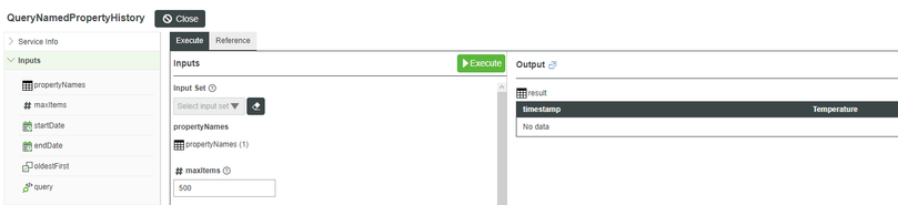

The properties are getting logged in InfluxDB Value Stream, when the Table/Measurement data is purged, the Latest/lastvalue is still seen on the Thing.
When Checked through QueryNamedPropertyHistory, there are no values for the property;;
Did following testing:
1. Restarted the Thingworx and checked, still the values exist
2. Cleared the Tomcat Cache and checked. still the values exist.
3, Imported the Thing from one Env to another Env, the values are still reflecting in another env, but again can't see in the QueryNamedPropertyHistory.
So if not DB, where are these values are getting stored ?
