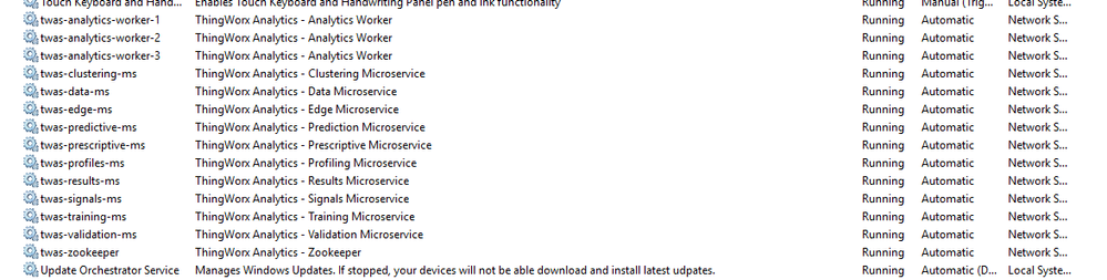

I am having an issue related to your comment in this thread. Attempting to install the Thingworx analytics server results in all the services being created, analytics server manager thing, resource provider thing, etc. But the analytics gateway thing does not get installed. Do you have any information on this issue?

You are seeing in your service manager, a bunch of services starting with twas ? This would indicate that you have a full installation of ThingWorx Analytics. Can you provide a screenshot of all the services running then?

We are trying to just run the free demo versions, which I've downloaded from PTC sites, they are versions 8.4.
It looks like the services are installing just fine and are running, but none of the Things the installer says it created are appearing in our platform.
Im not quite sure about the zookeeper service, more direction on how to locate that would be appreciated, I dont see any service named zookeeper (windows services).
Application key is not expired. I believe it was created with the analytics extension installation. Named: TW.AnalysisServices.ApplicationUserKey

I should also add, that the server did appear to install services, a bunch of services starting with "twas". Possibly it was the extension that did that? But I thought it was server.

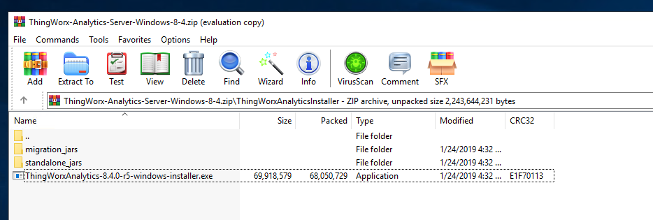

From the link I provided earlier, but drilling farther in https://developer.thingworx.com/en/resources/downloads/analytics-trial-edition
Selected the button "Download for Windows", theres a drop down to download either extension, or server. We've done both, extension installed fine. But the provided files for server are not working.
Screenshot of services:
The download gives us a zip file, and inside is a normal application installer:

Actually it appears someone tried to install the full version, 8.4.5, I'm not sure how. I think this is the issue. How would I uninstall this? I dont see the app in Windows Apps and I dont see any uninstaller apps.
ateed
(To:ateed)
And i found the uninstaller lol. I'll let you know if we need more help. I'm not sure where we got the full install from, but I doubt thats compatible with the trial platform.

And yes, you are correct, a full version of ThingWorx Analytics will not work with a Trial Edition of ThingWorx Platform Server.
