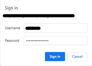

Hello Community,
For one of the platforms my company is running, each time I go to https://..../Thingworx/Composer/ I end up at a https://..../Thingworx/FormLogin/Myapp page instead.
I have checked my user and it does not have a home mashup:
If I do login using the form login page, I can then change the URL to /Composer and I can access the composer.
Does anyone have any idea why this is?

Hello @Velkumar,
It's not that I should not have access to the composer. It is just strange that for this particular platform, I am "forced" to login using the /FormLogin/ page.
On all other platforms, if I go to the /Composer/ URL, I get the normal "sign in" popup:
I have asked other colleagues and they do not have the same issue when trying to login to this platform...
Is there any settings perhaps that I can look at?

Is there maybe a custom Authenticator active (you can find it in composer, like Things there are Authenticators)? We did have a FormLoginAuthenticator (non official extension) at one point in our platform, which behaved like this I think.
jensc
(To:nmutter)
Hello @nmutter,
We do have some authenticators on the platform, but none are "enabled".
I think I'll open a case with PTC to see if they can figure it out.
From what I know, my colleagues do not face the same issue on the platform, so should be something with my user perhaps.
Thanks!
Jens C

After opening a case with PTC I tried clearing all of my browser cache.
This worked until I went to the form login page of the application that had gotten "stuck" again.
Then I started ending up on that form login again.
Since it is only on one platform of many, I'll leave this for now. In case anyone else also gets this issue it might be useful to know that it is possible to clear your cache to temporarily fix it.

Hello @slangley,
When you say org level, what do you mean?
I do have a home page set for the organization that is related to the form login page.
But I'm guessing that is not what you mean?
Jens

Hello @slangley,
Aha, maybe there has been a misunderstanding.
You are correct in saying that if I have a mashup in the "Home Mashup" of an organization, the user will be redirected there after using the organizations form login page.
However, my issue is that I get redirected to an organizations form login page when going to .... /Thingworx/Composer
And it is only on one platform that this happens.
On other platforms, even if I use the form login page of many different organizations, I can always just use the /Thingworx/Composer path to get directly into the composer.
So basically:
1. After clearing my cache and going to /Thingworx/Composer, I get the normal chrome login popup.
2. Using the /Thingworx/FormLogin/{organization_name} and logging in using it will redirect me to the home page of the organization (expected behaviour).
3. After step 2, logging out and then trying the /Thingworx/Composer path again, now instead of bringing up the normal chrome login popup, instead brings me to /Thingworx/FormLogin/{organization_name} from before.
4. Clearing cache again allows me to start over from step 1.
Perhaps it could be worth opening another case as this keeps happening.
Jens
