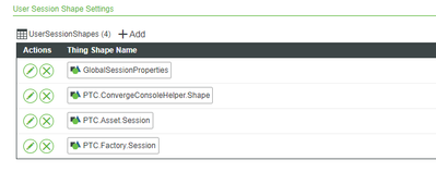

In 8.4 I can see session variable LastAssetChange while creating a mashup. But in 8.5, It is not present. Can someone please let me know where can I find these and what is the specific use of this LastAssetChange variable.

Look in the UserManagementSubsystem configuration and check if the UserSessionShapes match between your 8.4 and 8.5 environments.  If not, you can add them to that list.
Thanks, I found the necessary shapes in UserManagementSubsystem.
