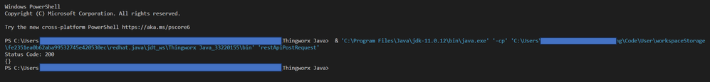

Thank you ,It works
I have used variable for content part like below
String jsonString = "{\"content\" : \""+b64+"\" ,\"path\": \"/Motivation.pdf\"}";

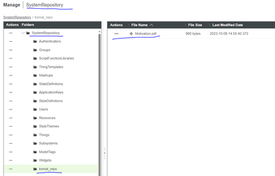

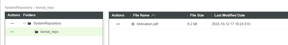

Hi @KN_9954684
I can status code: 200 which means the file got created in Thingowrx. Please check the Repository for the file.
It should be available in repository under folder komal_repo
/VR

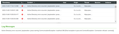

Yes it is, when tried with java code.But when I executed same with Thingworx code.getting error as below
Active Directory error occurred. [explanation: javax.naming.CommunicationException: localhost:389 [Root exception is java.net.ConnectException: Connection refused: connect]]
And file is also not getting created in repository.Any idea upon this?
Please post some screenshot
After exectuing savebinary service,I got the error
Hi @KN_9954684
There is some connectivity issue between AD and other systems. This is not related to a script error.
