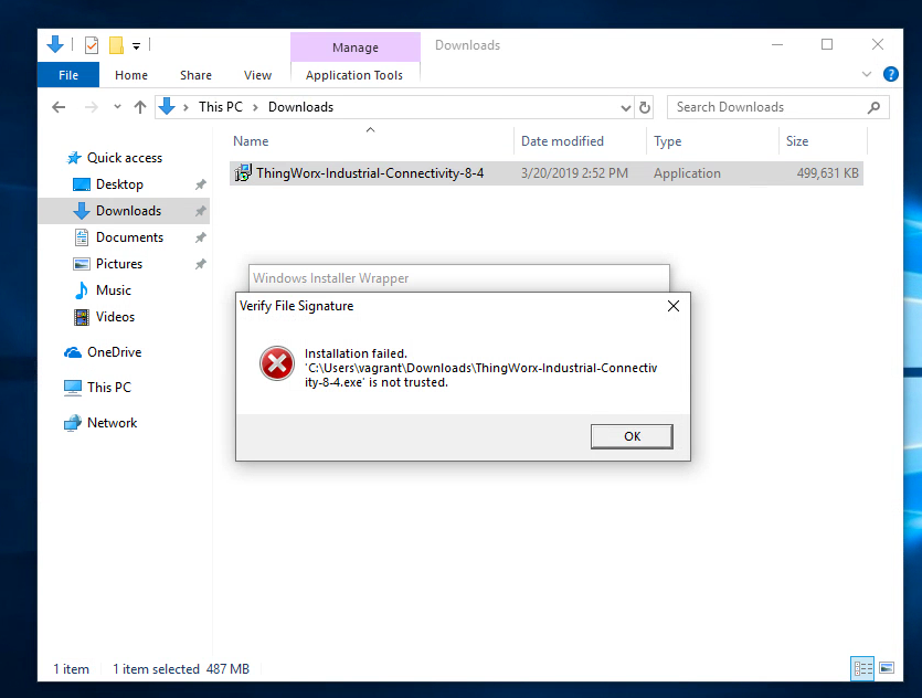

When I try to run the connectivity installer on windows I get the error
Verify File Signature
"...-Connectivity-8-4.exe' is not trusted"
Some windows magic required to install? I don't see anything in the install docs.

The install error was for an exe file mounted in a vagrant launched VM. The actual zip was downloaded and the exe extracted on ubuntu. The directory with the exe was mounted in the VM at /vagrant.
So I re-downloaded the zip directly in the VM, and extracted it in the VM. That extracted exe does run (no signature error).
Not sure what the issue was the mounted exe. But it's clearly nothing to do with thingworx.

Can you please specify what PTC Application you are attempting to install and where you downloaded it from on the PTC Support Portal specifically?
I tried to look around for "Connectivity-8-4.exe" but was unable to find anything.
A screenshot of the error and a link to the install doc mentioned would also be helpful.

It was "...-Connectivity-8-4.exe", which was short for "ThingWorx-Industrial-Connectivity-8.4.exe" (sorry)
trial downloaded from https://developer.thingworx.com/en/resources/downloads/indconn-trial-edition

This seems to be a common issue with Windows 10 and newer machines.
Lets try to have you execute the installer from an Administrator Command Prompt and see if this error persists.
If it does we may need to temporarily modify UAC settings to get it installed.

BTW, I did try that before first posting. No go. But as my solution post says, it seems to be more related to where the exe comes from.

The above was on windows server 2019. I then tried windows 10. Same problem. Not able to install.
