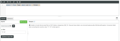

How to implement SQL query in thingworx as follows,
Query:
SELECT * FROM Customers
WHERE Country NOT IN ('Germany', 'France', 'UK');
In thingworx, how to pass country names as input parameter.

No. Im going to use this query in "Database Thing" as "SQL Query". So, I want pass comma separated values to this query. How can i do with Thinworx SQL query services?
Nov 9, 2021 11:46 AM UTC
you can try like this:
select * from user_model where name not in ([[name1]],[[name2]])
Where name1 and name2 are your service inputs.
