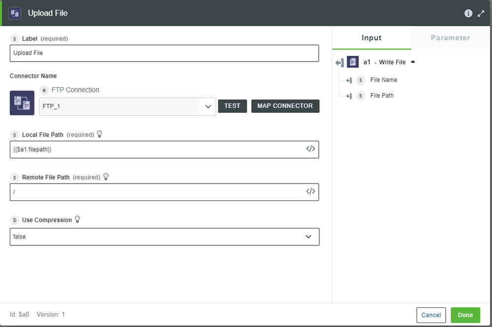

The upload file action gives the following error.
I have tried all the different paths that I can think of.

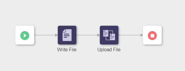

The file needs to be written first before it can be uploaded to the FTP server. Find an example below:
  1. Drag a File > Write File connector to the screen
    • This connector can have any input to generate the string that will be written to the file
  2. Drag a FTP > Upload File connector to the screen
    • Set the Local File Path to the output File Path of the Write File connector
    • Set the Remote File Path to the path you want the file written in the FTP server
      • Keep in mind the file will be written to the specified FTP root directory in the remote server
  3. Hit Save
  4. Execute the workflow
Find the simple workflow structure example below:
Find the Upload File connector details below:
The Upload File FTP connector is ideal for uploading files written during workflow execution. This explains why you were receiving Invalid path provided errors.
