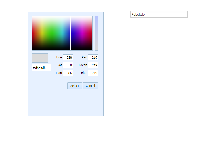

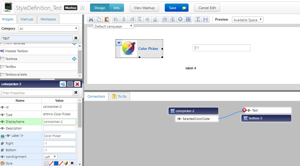

2)  I am using a colour picker widget downloaded from market place where the selected colour appears like a code. How can I bind the output of the selected colour from colour picker to the style definition?
