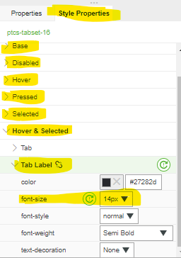

Have you tried to change Font Size in Tabs > Style Properties > Base,Disabled,Hover,Pressed,Selected,Hover&Selected > Tab Label > Font-Size?

Yes, I have tried this approach. However, in my project, there are a lot of screens where I'm using a tab widget. So, I'm looking for an approach that can make changes across the entire application in one go.
