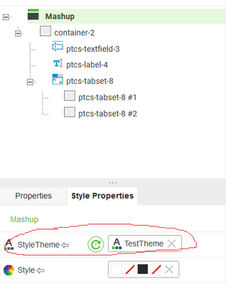

3. Now go to all your mashups and set the new Theme as the Style Theme for that Mashup, like this:
You'll now have a future-proof way of changing the style across all your mashups from a single place. Hint: you also have a CustomCSS section in the Style Theme, so in case you really need to use CSS now, you no longer need to spread your CSS across multiple mashups, or resort to store it in a Master Mashup etc.
