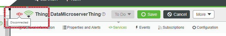

I have created a thing with base template as "DataMicroserver". I have created some services which using services defined in "DataMicroserver" template. The thing which I had created is showing as "Disconnected" in thingworx. Also I had check the value of "isConnected" property is also showing as "False". When I am running service using postman, getting response as "Thing is not connected"thing_disconnected_error.PNGthing_disconnected.PNG

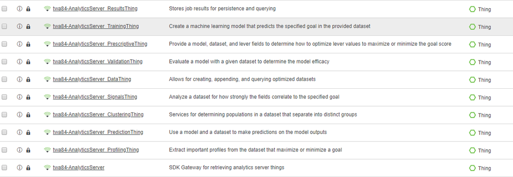

When ThingWorx Analytics Server (TWA) establishes a connection to ThingWorx Platform Server (TWX), it uploads 9-10 Things, which are used to communicate with TWA. There is no need to recreate the Things using the ThingTemplates, as they already exist for application use.
To use TWA on a service level, instead of the Extension Mashup, you need to use these services directly.
Here is a screenshot of the Things you can access:
The names may differ slightly for you, but the general format is <twa_server_name>-AnalyticsServer-<service>Thing
We do not have any tutorials on how to use these Things, as we encourage our users to use the Extension Mashup for their work.

The Datamicroserver template exists as part of a deployment of ThingWorx Analytics Server, this is automatically created by TWA when it starts. There is no need to configure anything, and should not be used to create a new Thing.
