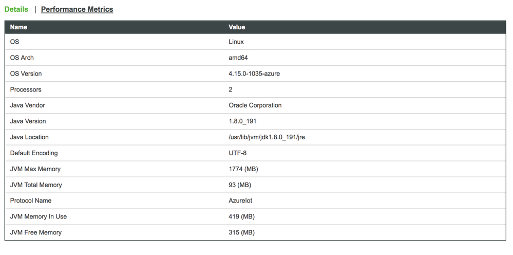

I was not able to identify the process using top, but I have the resource usage from thingworx:
The issue is not with ThingWorx rather your OS not able to allocate memory so output from Thingworx  resource usage page is not helpful. Can you provide output from top as explained earlier instead?
Logical and most likely solution to update memory in your VM as 7GB doesn't seams to be enough to run whatever processes you have running.

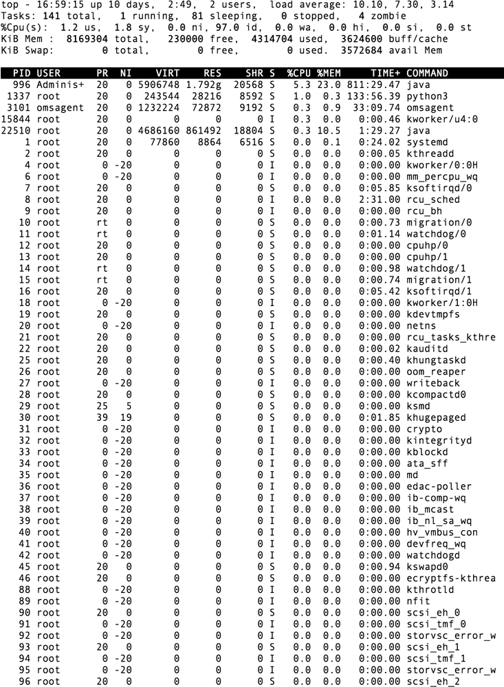

It is not so much what you are running but how much memory you have allocated to different Java applications as the total cannot cannot exceed available free physical memory. You have total of 8GB of physical memory and from top I can see:
~6GB used by one Java process
~4.5GB used by another Java process
~1.2GB used by omsagent
~1Gb used by the OS
total of 12.7GB so you need more than 8GB VM to run what you current running.
Now Thingworx requirement is min of 16GB, you can run in less by updating Xmx value for your Java apps to something like 4GB to make sure that you do not allocate more that your total available free memory but expect degraded performance because of that.
Thanks for you reply Marek. The 6GB process is the TW platform and the 4.5GB process is the TW connector. I will allocate less memory for these processes. I have not implemented any logic on the platform. I have just some remote devices mapped. It should not require too much resources.
