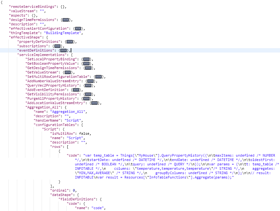

I am exploring the rest apis and java sdk apis for ThingWorx 8.5. I want to fetch the metadata of a Thing. I can do the same via REST api - <server/Thingworx/Things/{thing_name}. It returns json that contains all the services listed under key serviceMappings with their implementation under key serviceImplementations -
But the parallel java api on ConnectedThingClient getThing(<name>).getMetadata() returns _serviceDefinitionCollection and _serviceProcessors as null.
Am I missing anything here? How can I fetch the metadata for the Things' services ?

I have a Thing named MyHouse on the platform. I am trying to connect to the platform using following snippet -
VirtualThing myHouse = new VirtualThing("MyHouse", "Sample Description", client);
client.bindThing(myHouse);
client.start();
InfoTable metadata = myHouse.invokeService("GetMetadata", new ValueCollection());
 This returns an empty InfoTable instance.
When I used invokeService() api, I get the correct result InfoTable -
InfoTable metadata = client.invokeService(RelationshipTypes.ThingworxEntityTypes.Things, "MyHouse", "GetMetadata", new ValueCollection(), 30000);
Is this a correct way to connect to the platform?

Both methods should work the same. Client.InvokeService() needs to know what Thing you want to talk to. VirtualThing.invokeService() already knows this. The calls work the same way. The difference is that VirtualThing.invokeService() is dependent on the presence of Metadata either provided through annotations or through service bindings established on the platform.  You bypass all that with Client.InvokeService() and I should have offered that to you as an option in the first place. You are doing things the correct way.
Also, you are now doing the exact same thing you were doing when you were using the REST interface.
