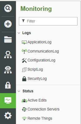

Have you taken a look in your script or application log to see if there is any errors?
You can find them here:
Alternatively, if you get an error message in the output of the service where you are trying to run this code, that could also help us find a solution to your problem.
