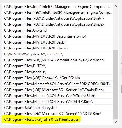

photo_environ_scan.JPGYes, you are right. It was upgrade yesterday but I didn't make the link between the two event due to the delay.
I add the path like you said but I still have the error did I miss something. I add the path on the environnement system. Path highlight on the capture.

Those "~" are artifacts of FAT16 filesystem, which only supported 8.3 filenames. Apparently Windows still maintains backward compatibility with MS DOS 6.22, which was deprecated 20 years ago. Pretty weird to see it in 2019, but...
I'd tried two things if I were you:
  1. Put full correct paths in that BAT file, like that:
    SET JRE_HOME=C:\Program Files\Java\jre1.8.0_221
    (do the same for CATALINA_HOME and THINGWORX_HOME as well)
  2. If that doesn't solve it -- why don't you just copy your JRE to something like "c:\jre8", replace the path in your BAT file and try again?
Also keep in mind that your PATH entry is incorrect, you need to remove "\server" from it.
For the future, installing all software in some simple directories like "c:\jre8" or "c:\twx" may save few nerve cells (use short lowercase alphanumeric names).

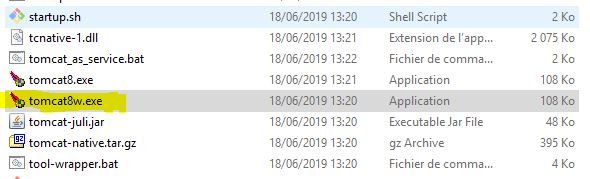

  2. Look for a file with a name similar to Tomcat8w.exe.  The filename for your installation may vary somewhat.  Make sure to look for a Tomcat executable with "w" in the name.
  3. Double-click to run it.
  4. If it runs successfully, select the Java tab:
Is "Use Default" selected?
If not, what path exists for Java Virtual Machine?
Is the path accurate?
Regards.
--Sharon
I have already try this solution after finding it on stackoverflow.
However it said that :
> The specified service does not exist as an installed service
I try execute it with admin right but it is the same. I think it is due to the fact that it is installed with thingworx.
