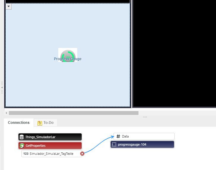

I'm using the widget progress gauge.
I have ever to used it on the thingworx 8.4 and it work well.
But now in version 8.5 I can't to use it well
What's happens:
I'm to bind the progress gauge to TAG from my PLC. There is value in TAG and it is communicate.
But whem I to run my dashboard the progress gauge is not show. Follow images below:
Can anyone help me with this?

Hi @einsfeldleo.
I found there we do have some pending cases on the Progress Gauge widget that are not yet targeted for a fix date/release.  However, it is recommended that you upgrade to the latest patch release (8.5.1 or 8.5.2) due to the number of updates affecting widgets contained in those releases.  Once you have done so and have re-assessed, please let us know if you still have issues and I will raise the awareness with R&D.

Hi @einsfeldleo.
It's recommended that you upgrade to the latest patch release, 8.5.2.  Improvements were made to a number of widgets though I can't speak to the Progress Gauge specifically.
If you still have problems after upgrading, let us know and we will investigate.

Hi @slangley
Thank you for answer.
I'm using the version 8.5
When I was to use the version 8.4 the progress gauge widget was work well, but in this new version it does not work yet.
Can someone help me?

Hi @einsfeldleo.
Unfortunately, no.  If you're running the 30-day version you won't be able to upgrade it.  You can download and install the 90-day version and would have the ability to upgrade that one as long as you own a license.

Hi @einsfeldleo.

Hi @slangley
I'm using the trial version (free for 30 days)
Can I do upgrade this version? If yes where can I do download this upgrade?
