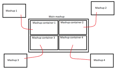

The Auto-refresh function in Mashups 1, 2, 3, and 4 works as expected, but once those mashups are included in the main mashup using the mashup containers the auto-refresh function configured for the main mashup doesn't update the states shown in each mashup.

I implemented the approach suggested by @c_lowy using the legacy Auto-Refresh widget instead of the function. It works but only if the contained mashup occurs in only one level.
I made a test with this approach but to get each mashup updated in the main mashup the system is sending a lot of requests to the server.  I worried about the possible bad effects that this could imply on the performance of my application.
Looks like the solution to this issue will be published in future releases. "Fix planned for ThingWorx 9.1.3 "Corrected in ThingWorx 9.2.0".

hi sarjasalc, sorry to reply late.
As 9.2.0 is already released, the best solution is to upgrade to 9-2-0. Below is update manual on TW HelpCenter.
https://support.ptc.com/help/thingworx/platform/r9/en/index.html#page/ThingWorx%2FHelp%2FInstallation%2FInstallation%2Fupgrading_to_9_1.html%23
Btw 9.1.3 will be release soon, so you can also wait this version.

Apologies!  ThingWorx 9.2 is targeted for release in June.  There is always a possibility, however, that the date may change.

So, I will wait until June for the new release version thank you for the response @wcui. My apologies for responding so late. I really appreciate your help.
