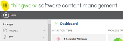

Please try to view the mashup with master in URL link like below given example.
Ex. https://<<YOURSERVERHOSTDETAILS>>/Thingworx/Runtime/index.html#master=TW.RSM.SFW.Master.ApplicationMaster&mashup=TW.RSM.SFW.Mashup.SoftwareDashboard
Or

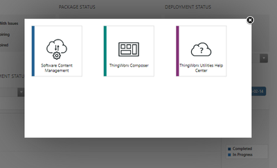

 Once view the mashup "TW.RSM.SFW.Mashup.SoftwareDashboard" from TWX Composer. Please follow the steps mentioned below.
1) Click the Menu button in top lef corner. It will open the popup with quick menus.
2) Then click the "Software Content Management" Tile
I hope it will helps you.
Or

It works if I copy paste the URL but does not from the tile approach. A support case has been raised for the same.
