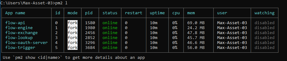

Hello all,
I have installed Thingworx flow and configured with Thingworx. When I try to open flow using link : http://localhost/Thingworx/Composer/apps/flow . I'm getting error as "404 page not found".
Could anyone help me to fix this issue ?

Its not working and I found all services running properly in instance

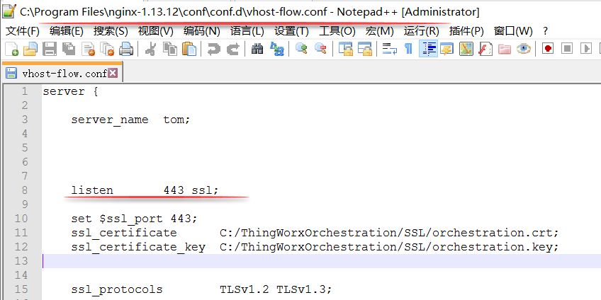

@Velkumar
Please check the following file.
Mean while, please notice  my server name  is “tom”, so I have to config my host file as:
192.168.58.196 tom

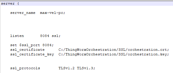

Velkumar
(To:weli)
Hi @weli
I have configured port number as 8084.
weli
(To:Velkumar)
Then you should use url:
https://localhost:8084/Thingworx/Composer/apps/flow
or
https://max-vel-ptc:8084/Thingworx/Composer/apps/flow
