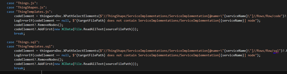

@htran-21 Thank you!  One final question.  How are you merging your JS/SQL back in to to the XML so that it can be re-imported to TWX?  I'm really hoping this is not a copy/paste operation :)
htran-21
(To:wposner-2)
Hi @wposner-2
No, everything is automatic, just perform merge task, and the final XML would be merged with the latest local/remote changes
