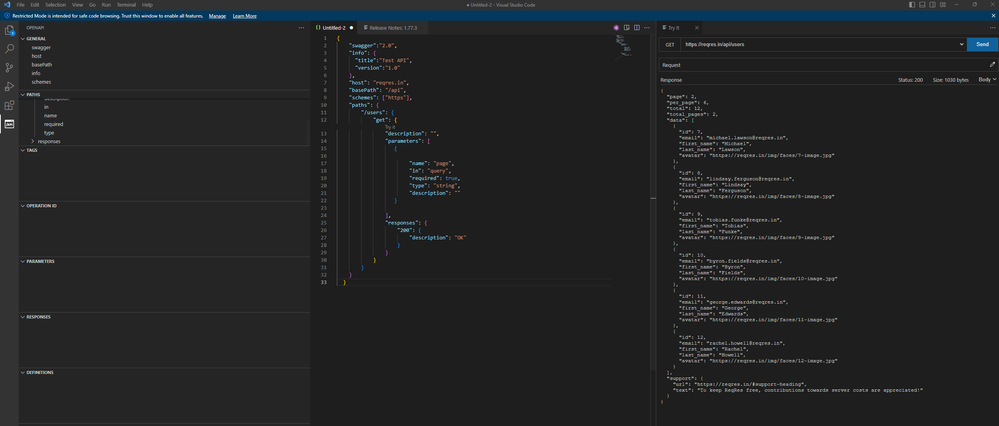

As I told you in my previous post you have to create swagger JSON manually to get the endpoint list.
Step 1: Create Swagger JSON. You can use VS Code Plugin - OpenAPI (Swagger) Editor - Visual Studio Marketplace to create JSON. Note: Thingworx supports OpenAPI v2.0 only
Swagger JSON should look something like this
Below JSON consists of endpoint - https://reqres.in/api/users?page=2
"swagger":"2.0",
"info": {
"title":"Test API",
"version":"1.0"
"host": "reqres.in",
"basePath": "/api",
"schemes": ["https"],
"paths": {
"/users": {
"get": {
"description": "",
"parameters": [
"name": "page",
"in": "query",
"required": true,
"type": "string",
"description": ""
"responses": {
"200": {
"description": "OK"
Step 2: Update JSON value in Connector Property SwaggerJSON
Step 3: Execute GetEndPointList to get endpoints
