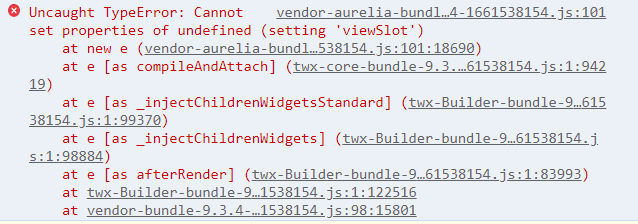

Hi everyone,
I have been working on a custom widget and everything is working as expected except for the bound data. The property is unable to set bound data, and I am getting an error in the console that might be related.
Any help is greatly appreciated. I've scoured the internet and forums for any help on this. I honestly think it is an error with my thingworx environment or dependancies of thingworx at this point...
Here is the error I am seeing:
Here is my IDE Code:

Hi Constantine,
Thank you for the reply and for linking that repo that was extremely helpful. I still have not solved my problem, but I think I am closer.
The main issue I am facing is the function this.UpdateProperty() is not being called. Any idea why that might be?

Just a couple of thoughts:
  1. Looks like you commented out a bit too much, e.g. you use "thisWidget" variable in updateProperty, but you initialize it in the commented out block.
  2. Consider using this.xxx for those "shared" variables, e.g. this.valueElem;
  3. This error suggests something screws up ThingWorx runtime. This is often caused by misbehaving extensions. Therefore, a). Try to remove other extensions or just retry on a virgin ThingWorx installation; b). Double-check that you imported the latest version of your extension; c). Restart ThingWorx, clear your browser cache, and retest in a Private browser tab;
  4. When nothing helps and I'm stuck with my UI extension, I restart from scratch at some point, i.e. take an empty minimal example and import it, ensuring it works. Then start (re)adding your logic into it. Here's my go-to minimalistic example, which handles binding correctly in 9.3.x: https://github.com/vilia-fr/twx-infotable-to-json-ext
Good luck!
/ Constantine

Hi Constantine, this was useful as I was able to use this repo as a starter template and get the bindings working and compare to what I had to see what I was missing.
For reference I was missing the <div class="widget-content"></div> around my entire widget. Ad
Update - I still have not found a solution for this. I found another thread with the same issue: https://community.ptc.com/t5/ThingWorx-Developers/Custom-widget-updateProperty-will-not-called/m-p/555833#M29203
I am running TW version 9.3 and TW Extension SDK version 9.3
