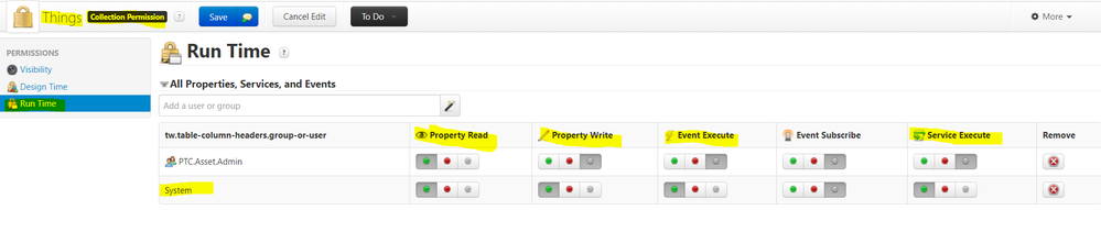

The System user is a built-in user for executing services without having to give the logged in user explicit permissions.  Here is a screenshot showing access to the Things Collection by the System user:
Based on your scenario, you will need to provide a number of permissions to be able to perform the various functions (create, update, etc.) but there is no simple answer that would provide a solution.  You will need to rely on the log output to address each of the permissions issues as they occur.
