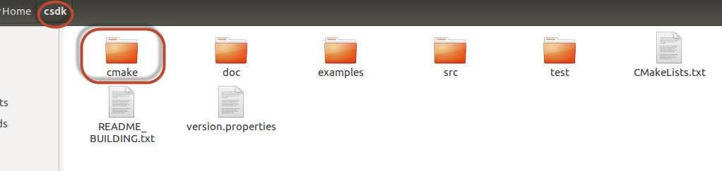

Hi @gkumar-21 after downloading and unzipping the csdk you should see the cmakelists.txt file available under the root folder.
If you are running from linux based platform:
1. create a directory under the c sdk root folder, with any name something like this
I have named the folder as cmake, notice that i am under csdk folder which contains the CmakeLists.txt

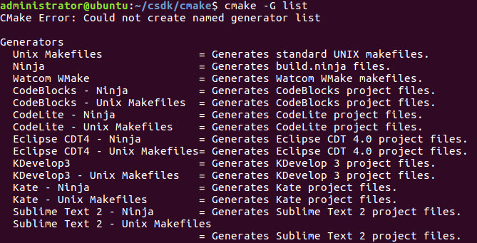

2. CD into the cmake and check for the available compilers with cmake -G list
and then use the required compiler e.g. cmake -G  "Unix Makefiles" ..
