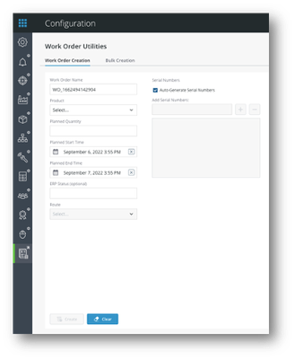

I created a Building Block that provides an UI and uses the Job Order End Point of the ThingWorx Applications to create Job Orders for CWC in an easy way.
This extension is not official and their is no support for it but your are welcome to use it or build your own UI based of it.
I attached  version 1.0 including installation guide and user guide.
I am currently working on version 2.0 that will include the missing BOM support, UI enhancements and excel import features.
This version should be available in a few weeks and i am happy to share it as well.

There is no option to use the UI to create job orders.
However, there are some CORE functionalities called end points that can be used to create data as job orders, products, etc.
Here is the link:
https://support.ptc.com/help/thingworx_applications/r1.0/en/?_gl=1*fq7d4b*_ga*MTY5MzI3NTIzMS4xNjgwMTA1ODQx*_ga_1QBT6P6HR1*MTY4OTAwMTc3My43My4xLjE2ODkwMDE4MTcuMC4wLjA.*_ga_CBN5QVB9VJ*MTY4OTAwMTgxNy42My4wLjE2ODkwMDE4MTcuMC4wLjA.#page/thingworx_applications/setup_source/Common_Endpoints_Config_LP.html#
