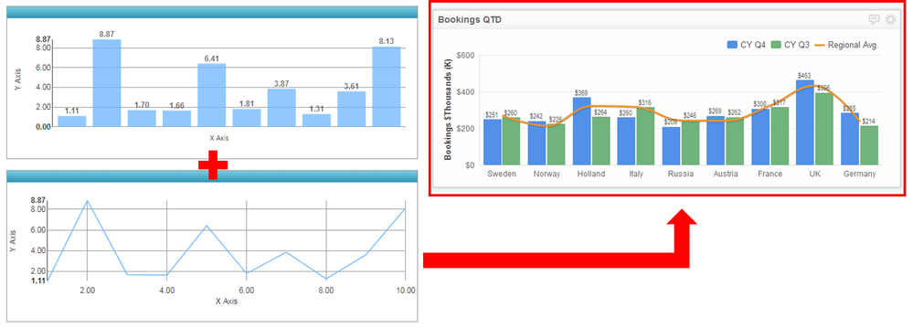

still now, i using time series widget to display dynamic log value(i.g. sensor data)
but some demos display log using line/bar graph in mashup
how i get line/bar graph(chart)?
i downloaded Custome chart widget from Thingworx marketstore and display log using that
but that was not show line/bar together
and Custom chart widget just display value only one
How i show log value at chart via line/bar?
I want combine a line chart and a bar chart
thanks

Hi SeonHo Cha,
In Label Chart, for each DataField you can choose different SeriesType i.e bar or line type.
PFA

Hi SeonHo Cha,
PFA
Velkumar R
thank!
I am not accustomed to English, so what does "PFA" mean?
Please Find Attached
