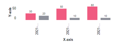

I am trying to display x-axis as DateTime but in my use case i need to show only time (hh:mm) at X-axis. there is property for Y-axis format but not for X-axis. how to do it in Bar chart ?

This is a limitation in 9.x Chart Widget(Bar, Line) but good news is this feature has already been reported as an enhancement and should be available in next release i.e. 9.2.0
I can update on this thread when the release is out but for now workaround is to send the x-axis data in required format from the service itself which feeds your Chart.
You can follow this post to modify your Date format: Change the date time format
