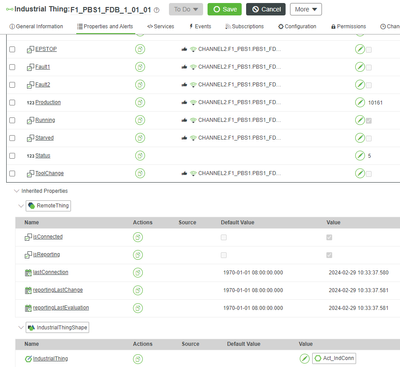

YC_10946483
6-Contributor
(To:Velkumar)
this thingName which i filled is a  edge thing and this serviceName is in this thing
Velkumar
(To:YC_10946483)
It should work. Dynamic Subscription won't be visible in composer.
You can use "IsDynamicSubscriptionCreated" to check whether the service is created or not
