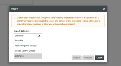

In order to use this framework you'll first have to import the excel extension and afterwards the framework entities.
Step 1: import the "excel extension.zip" as extension to ThingWorx
Step 2: extract the "FRM-Entites.twx.zip"

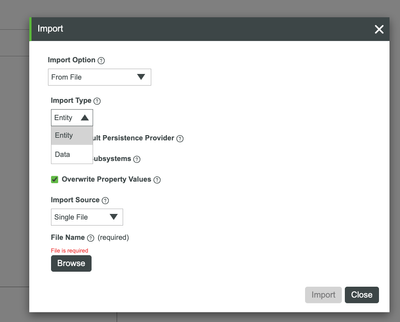

Step 3: Import the "FRM-Entities.twx" as Entities (From File->
