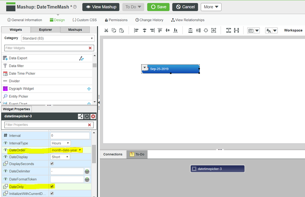

Hi, How can I assign the formatted date to Date time picker? because it converts the date to string format and doesn't allow me to bind to the date time picker. Please provide a solution for this.
I tried to assign the following query but I am not able to
select CONVERT(varchar(12), CAST(getdate() as date), 107)

Hi @svisveswaraiya.
The properties panel for the Date Time Picker widget allow you to select from various formats:
If there isn't an acceptable format available, please provide me with your entities to provide more context around your needs, and I will work on an alternative.

Hi @svisveswaraiya.
The DateTime picker is expecting a Date Time type.  Is there a reason you're trying to convert it to a string first?

Hi @slangley ,
I am trying to convert it because I want it to be in the MM/DD/YYYY format of previous day's date.

Hi @svisveswaraiya.
