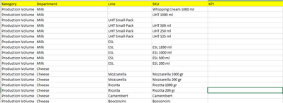

I want to do drop down layer by layer. for example. if I choose Production Volume and choose milk, next layer cannot show “Mozzarella” in the drop down.

Yes. Let me show you my logic.
First, I created one datashape, which included first layer name(string type) and next layer(infotable type). and I create Datatable which used this datashape.
but my question is after I want to input data in the datadatable, only first layer name can put data, infotable cannot put data.

xiaoqw
(To:PaiChung)
you can see from my file inserted. I cannot edit infotable data in the datatable.
