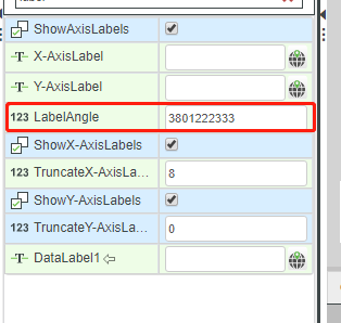

how to adjust label angle in custom widget extension?
xiaoqw

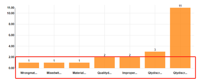

based on my requirement, I need to use LabelAngle. but it not works. May I know what wrong with my input in LabelAngle?
slangley
(To:xiaoqw)
Hi @xiaoqw.
The value you entered for label angle is working under ThingWorx 8.4/Chart widget extension 3.0.3.  However, we're not understanding the value you entered for angle.  We would expect it to be something like 90 or 45 degrees.  Could you try this to see if you get different results?
Regards.
--Sharon
