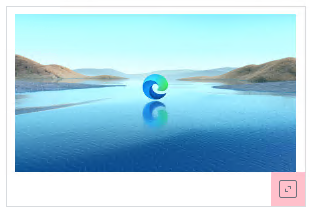

i made you an css, so you can understand how to use it in the future.
1. ValueDispaly Widget, that renders an Imagelink.
2. Use "height: 0px !important;", to hide the lower part named: disclosure-button-overlay. Here I made the background red for you. I am not sure if you want to hide the whole overlay, but in case you need it, I will add the css.

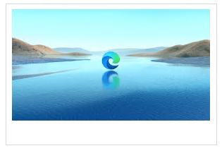

2a. After you removed the overlay, it should look like:
3. Now to hide the disclosure-button itself, you add "visibility: hidden !important;".

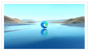

3a. The result should look like:
I hope, that i was able to help you :).

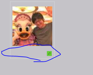

Hi Markus,
Really appreciate for your quick response.
I tried but not work.(ToT)

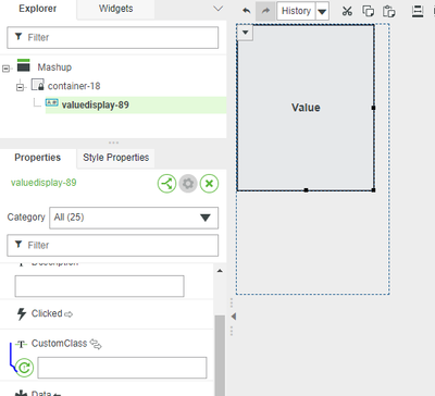

I put pictures of my code and mashup configuration.
Could you tell me what is wront ?
my valuedisplay shows image not imagelink.
I write Custom CSS as shown the blow.
I think I dont need any configuration to valuedisplay itself since I specify elements in the CSS, right ?
