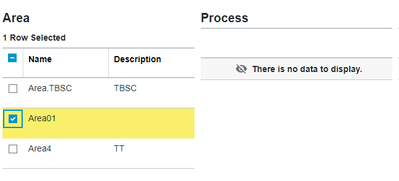

if I click on a row that I want, it automatically checks the checkbox in the selected row. Is this p
TW_10599876
I would like a method where, if I click on a row that I want, it automatically checks the checkbox in the selected row. Is this possible? Or should I click on the checkbox, and it will act as if I clicked on the row?
1 ACCEPTED SOLUTION
Hi @TW_10599876 ,
There are a couple of workarounds for the Situation:
  1. Make the Grid Selection Single, but a single row can only be clicked at a time and then use the Selected rows
  2. Use a Collection Widget, which makes this use case easy
  3. Then, If you are using Thingworx version 9.4+, use the row clicked and pass it back to Selected Rows to Gird; that should work.
