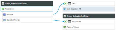

Hello @dgg
Adding to Travis's post, this is what the connections could look like:
You could also use the "SelectedItems" property of the dropdown widget, however I have had more luck with the "Selected Row(s)" from the service.

I changed the input type of the service to InfoTable of the same DataShape, refreshed the mashup, and mapped the Selected Rows attribute itself (as opposed to the underlying column of interest) to the input parameter of the second service.  The service now works.  I knew it was something stupid that I was missing.
I really appreciate the help.  And thanks @jensc for the image - that helped too.
