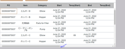

Dear Developers,
I'm using ptcs-grid widgets in some mashups which asssumed to be used with iPads.
if there are a lot of columns in grids, I expected to be able to see a horizontal scroll bar like the below.
however, we cannot see the scroll bar on all iPads.
Could you let me know how I can fix this trouble ?
I use chrome on both laptop and iPad.
the width of all columns are fixed.
screen shot of my laptop ( display mode : iPad landscape )

Hi @Yoshihiko.N.
Mobile devices don't necessarily handle scrolling the same way you expect to see it on a laptop/desktop.  Often, scrolling is available but no scrollbar appears until you begin to scroll and even then, it really depends on whether the developer chose to display scroll bars or not.  With today's technologies, it's expected that scrolling is available even without scrollbars.
In regard to the 9.2 version, you are using a Preview version of the widget.  ThingWorx 9.3 contains the updated grid widget with corrections to some of the issues discovered in the preview.  We can't say whether moving to Grid Advanced will resolve your issue, since we no nothing about your application.  You will need to test it.  If you do have problems, you will either need to develop your own widget or upgrade.  We just ran a simple test, but scrolling seemed to work fine on 9.3.
If you would like to make some suggestions regarding scrolling, please feel free to post your requests on the ThingWorx Ideas board.  This will allow others to vote for them.

Even though a scrollbar doesn't appear, does it allow you to scroll?
we can scroll vertical direction though cannot scroll horizontal direction.

>Did you confirm there are columns outside of the visible area that you can scroll to?
Yes, I confirmed there are 7 columns in outside of the visible area on laptop.
however, we cannot scroll ( column direction) on iPad.
screen shot on laptop
screen shot on iPad
I'm using Grid(preview) not grid advance.
