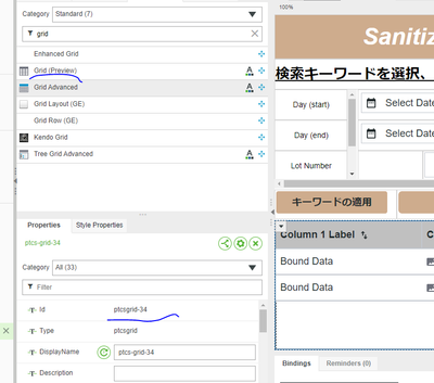

Dear Developers,
I'm using ptcs-grid widgets in some mashups which asssumed to be used with iPads.
if there are a lot of columns in grids, I expected to be able to see a horizontal scroll bar like the below.
however, we cannot see the scroll bar on all iPads.
Could you let me know how I can fix this trouble ?
I use chrome on both laptop and iPad.
the width of all columns are fixed.
screen shot of my laptop ( display mode : iPad landscape )

Yoshihiko.N
(To:slangley)
Hi Sharon,
Thank you for your reply and the following is my answer.
>Did you confirm there are columns outside of the visible area that you can scroll to?
Yes, I confirmed there are 7 columns in outside of the visible area on laptop.
however, we cannot scroll ( column direction) on iPad.
screen shot on laptop
screen shot on iPad
I'm using Grid(preview) not grid advance.
