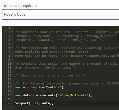

I am trying to install within nodejs module the mathjs library to be able to use the unit converter. I have a problem to install an external library. I followed the guide on the portal but i can't install the module and whitelist it.
At first, I install mathjs into ThingworxFlow folder
cd C:\<PROGRAM FILES>\ThingworxFlow
npm install mathjs
I run the command to download the settings file
flow-deploy settings download -f ‘.\settings.json' -t "https://<url>:443/Thingworx" -u 'Administrator' -p ‘pass' -c devtools -s default -l debug
I edit the whitelistExternal with "mathjs" and then upload
flow-deploy settings upload -f ‘.\settings.json' -t "https://<url>:443/Thingworx" -u 'Administrator' -p ‘pass' -c devtools -s default -l debug

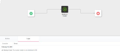

but from flow keeps telling me that it is not whitelisted. What can I do?

Please provide a link to the guide you are referring to and provide the version of ThingWorx/Flow you are running.
Did you get any errors when you ran the commands?  We can see in the statements you provided, you're using smart quotes in some cases, which could be causing an issue:
Regards.
--Sharon
Hi, i follow this guide
https://support.ptc.com/help/thingworx/platform/r9/it/index.html#page/ThingWorx/Help/Integration_Orchestration/ConnectorDevelopmentSDK/DeployingConnectors.html
About smart quotes I think are copy/paste error on this forum because the command correctly run into powershell.

Could you please provide the settings.json with your changes?

Looks like you sent the wrong file.  In your script, you are referencing settings.json.  That is the one we need.

Is it possible that you got an error on upload?  If you're not sure, try it again and let us know.  In the meantime, I'll work on setting up my environment to be able to test it.
