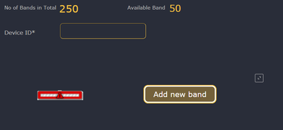

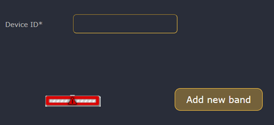

getting an error "Unable To Parse JSON Request" while adding device id through mashup.
i have one code which gives me existing device id in database and i my another code is validation service created for the mashup where i wanted to compare device id present in database with the validation service input device id.
Now when i click on add band button it gives me an error "Unable To Parse JSON Request" i dont know why i am getting this error. below is my validation service code:-
// result: INFOTABLE dataShape: "checkBandDeviceDataDS"
let result1 = me.checkBandDeviceId({
device_id: device_id /* INTEGER */
if(device_id == "" || device_id == null){
result = 'Please enter device id';
else if(result1.device_id == device_id){
result = 'This device id is already exist';
else {
result = '';
above code is running perfectly when i run the personal code but it's not running through mashup, please suggest some solution on this, below is snapshot for your better understanding
nmillesonAnswer
Feb 23, 2021 2:34 PM UTC
I run into this issue occasionally when I try and pass Integers into a service in a mashup.  My workaround has been to change the service input type to a String and then do a parseInt() in the service.
