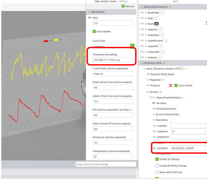

May I know if anyone have tried to use Studio 3D Chart Widget extension to display time series chart in 3D eyewear AR experience?

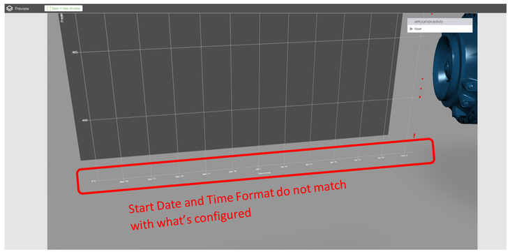

I have difficulties in configuring the timestamp format and start date for the chart. It seems that the widget doesnt correspond to the format I configure (both timestamp and start date value).
Preview result
Studio Configuration
Regardless of the issue, I tried to publish the experience and view it in Hololens (both 1  and 2) but the 3D chart doesnt seem to appear in the experience. Not sure if this widget is really supported in 3D eyewear.

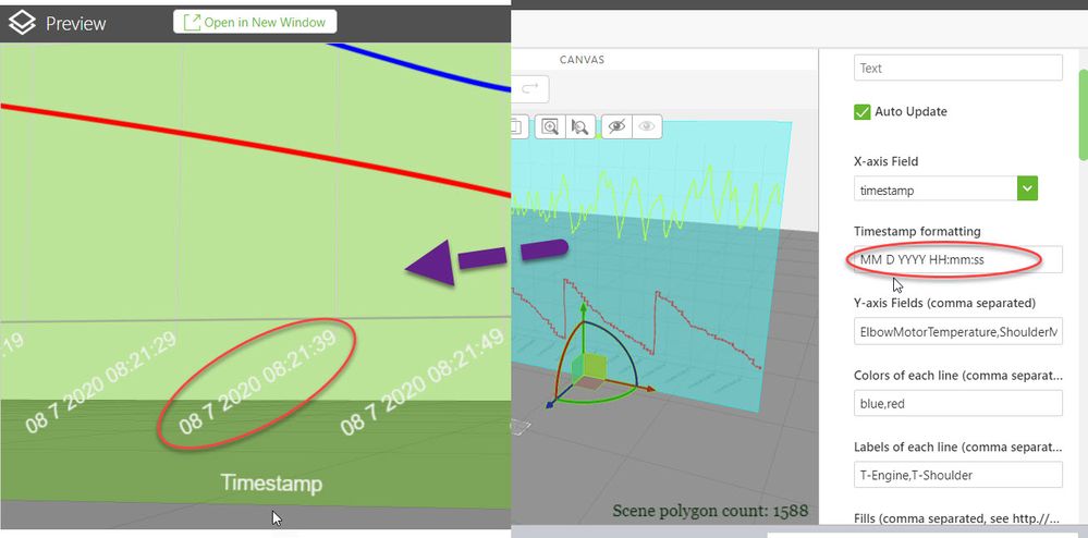

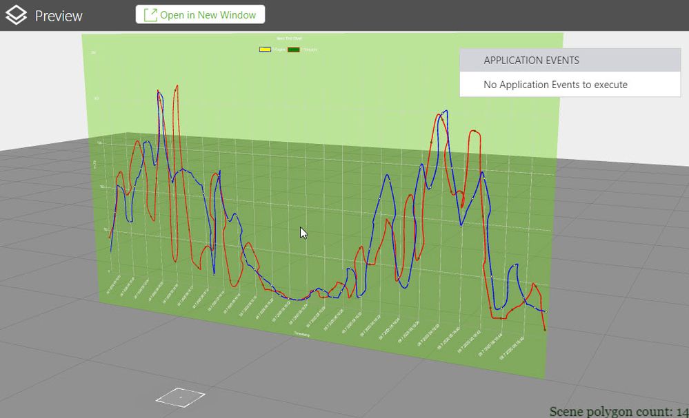

I tested now this widget and it was working fine in preview mode of 3DEyewaere project.
Here the display in preview mode of the 3D chart :
I think according to the date format  - I think there are 2 different points
The one point is the format of the display - this is widget specific  - here the property  Timestamp Formatting:
And so far my observation - it displays correct the timestapm date/time format

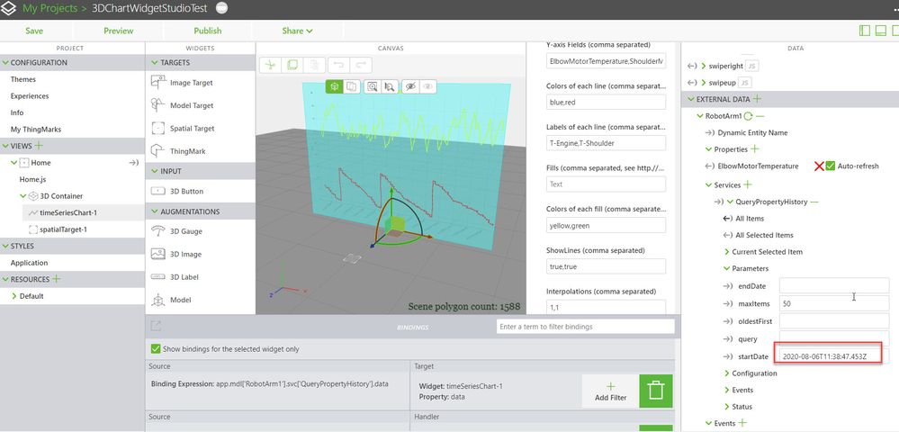

The another point is according to the value what we pass to the QueryPropertyHistory   TWX service. Here I used the same format as the timestamp value in TWX and it was working fine:
so here in example value:  2020-08-06T11:38:47.453Z
Is the same as the table value in TWX e.g. in this sample data:
 var data = [{"id":"176432837","SENSOR10":4,"timestamp":"2019-07-17T11:38:48.254Z","_isSelected":true},{"id":"176432862","SENSOR10":6,"timestamp":"2019-07-17T11:38:48.153Z"},{"id":"176432836","SENSOR10":9,"timestamp":"2019-07-17T11:38:47.953Z"},
,{"id":"176432701","SENSOR10":6,"timestamp":"2019-07-17T11:38:45.353Z"}];
 So , in preview mode is working fine but  I also did not it get working  on HoloLens. Depending on the size of the panel I see that the object box of the HoloLens has different size - and is updated accordingly but the 3d Chart was never displayed. I will report this to PTC R&D may there is some helpful feedback. Thanks
