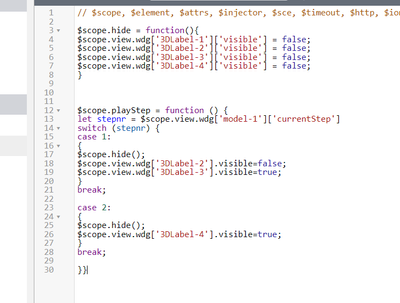

Hi @Karthik ,
So basically what i mean is, you can define a function like below:
$scope.hide = function(){
$scope.view.wdg['3DLabel-1']['visible'] = false;
$scope.view.wdg['3DLabel-2']['visible'] = false;
$scope.view.wdg['3DLabel-3']['visible'] = false;
$scope.view.wdg['3DLabel-4']['visible'] = false;
$scope.playStep = function () {
let stepnr = $scope.view.wdg['model-1']['currentStep']
switch (stepnr) {
case 1:
$scope.hide();
$scope.view.wdg['3DLabel-2'].visible=true;
$scope.view.wdg['3DLabel-3'].visible=true;
break;
case 2:
$scope.hide();
$scope.view.wdg['3DLabel-4'].visible=true;
break;
Let me know if this works for you
BR,
Mohit
Thanks Mohit,
that works for me.
