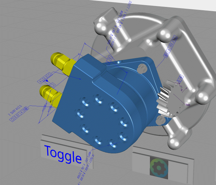

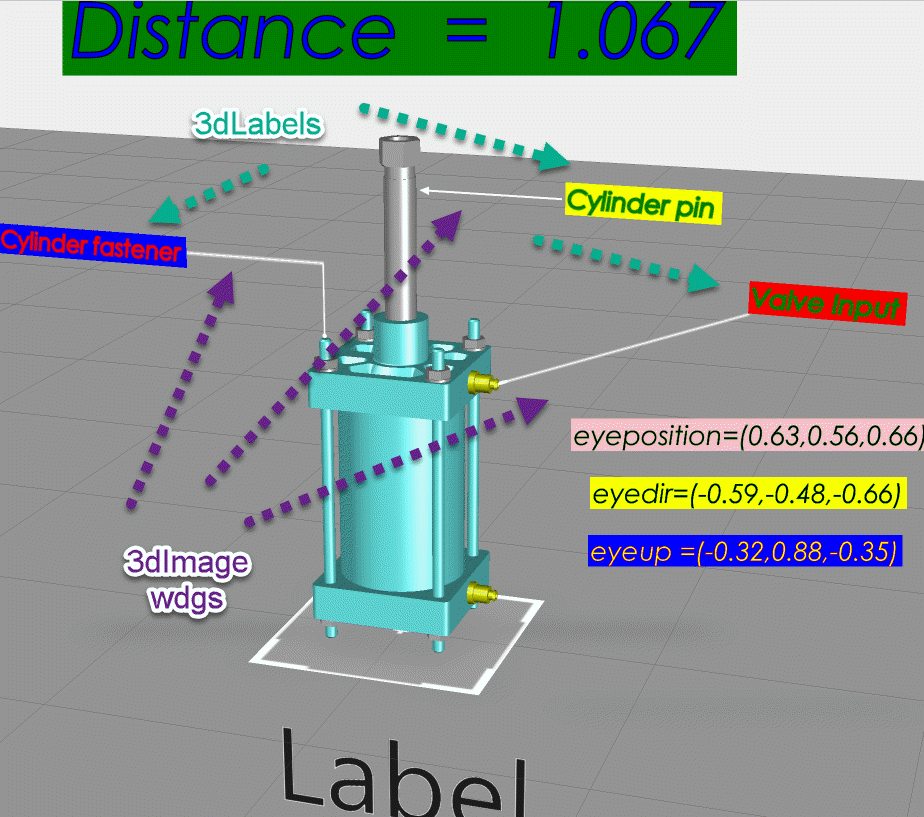

In the means time is possible to show a Creo Parametric Annotation in  Studio / in Creo Parametric style:
Based on the current functionality (as already mentioned) we can use a combination of 3d Images  and / or 3DLabels – some thing like this:
