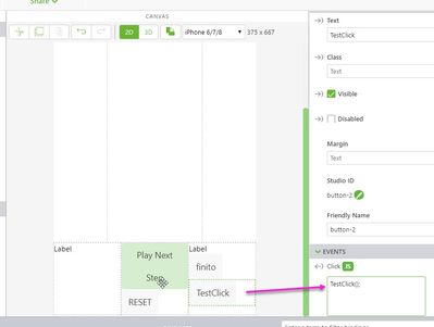

I have pop-up instruction steps with animation showing connecting cables to the 3D model's rear. When the user clicks the button to open the last step I want to rotate the 3D model to show the front panel LEDs that light up. Could you give an example of how to do this with JS?
writeratcdd
(To:writeratcdd)
http://support.ptc.com/help/vuforia/studio/en/#page/Studio_Help_Center%2FBeginner_JSInvokeFunction.html
The link above helped me get a button click to invoke a JS function to rotate the 3D model. However it appears to break the functionality of the rotation slider I set up for users. Also, I'm not sure how to rotate the 3D model back to its original position when the user closes the instruction pop-up. Creating another JS function seems to have stopped the original desired rotation from working.
Hi @writeratcdd ,
I think the best approach will be to define the position - e.g. the rotation about Y model axis, via a parameter and let the script change your parameter - so the script could do some think like:
$scope.app.params['YROT']=0
$scope.TestClick = function () {
$scope.app.params['YROT']=parseFloat($scope.app.params['YROT'])+5.0
So here I will call the TestClick from a button click event :
Then you can bind the value of the slider in 2 direction to the parameter so that change of the slider value will change the parameter and also  a  change pf the parameter will change the slider.
Then you can also bind the parameter value additional to the model Y rotation and test.
Now a click of the button will change the rotation of the model but will also update the slider
