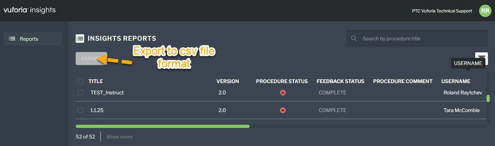

Hi @Y.Moto , so far I see your mentioned Vuforia Insight- I am not sure if this is correct.   For me is this point a little confusing, because the Vuforia Insight so far I know, is part of the Vuforia Capture Cloud product and is not directly related to Vitoria Studio.  I also do not see any direct relation to the  Experience Service or Thingworx instances so that solution of any TWX extension could not be used in this case . The Vuforia Insight is module where you can track and auditing  the results of capturing procedures. Please, refer to https://support.ptc.com/help/vuforia/editor/en/#page/vuforia_editor%2Fvuforia_work_instructions_intro.html%23
Vuforia Instruct is an out-of-the-box solution that enables you to leverage 3D CAD to easily create, deliver, and scale interactive work instructions to frontline workers.
Vuforia Instruct provides frontline workers the benefit of in-context, digital 3D work instructions overlaid onto the parts to be inspected. This enables workers to improve their accuracy and productivity, resulting in reduced cost and fewer delays in production.
When you have access to   Vuforia insight module you will be able to export your reports or a set of reports filtered by customer filter UI to csv file.
So later a csv data could be used by many different application programming libraries , tools or  product where you can create you orwn reports /Tables or charts/ and of course save them later to PDF files.
