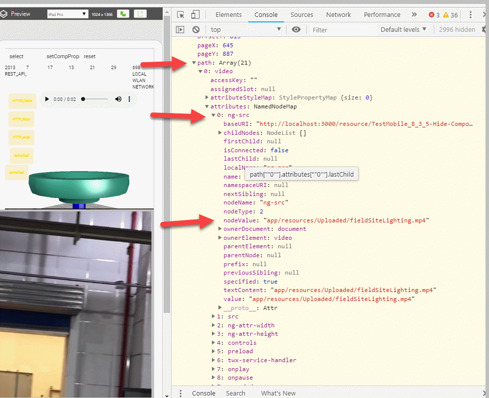

Hi @ClayHelberg ,
here I want  to clarify it furhter based on my experience.
So in the @mn1 's example the solution is based on particular windget configuration and will not work and every project - so need adoption in particular situation . So I did an example and it the code was not working in this case. So to get it working I needed to go in chrome in the  console debugging  Strg -Shift -I and  do some thing like:
document.addEventListener('click', function(event) {
console.log("click() 1 called");
 console.warn(event);
And then to check the console warning in the console window and to try to explore the current setting of the event object:
In my case for the video widget  the correct expression should be:
if (window.event.path[0].tagName=='VIDEO'){
console.log(window.event.path[0].attributes["0"].nodeValue);
 // If a video was clicked, this line prints the video source
console.log(window.event.path[3].attributes["0"].nodeValue);
