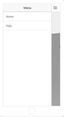

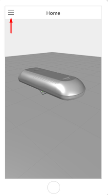

One of the ways to implement this scenario is by using Multiple views. In Vuforia Studio, you can create multiple application screens. By default, a Home View is created upon the creation of new experience. To create a new view,
  • Create a + icon next to views, Type a name in the name field and choose 2D view
  • Add required widgets in this 2D view
  • Preview the experience. The first view on the list will be your starting screen for your application. In the top left corner there is a Menu button which enables us to switch between views as shown below:Screenshot_28.png

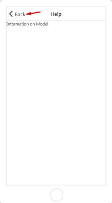

  • Clicking on Help will navigate to Help View. In the top left corner there is a back button to go back to the Home viewScreenshot_30.png
Hope this helps!
