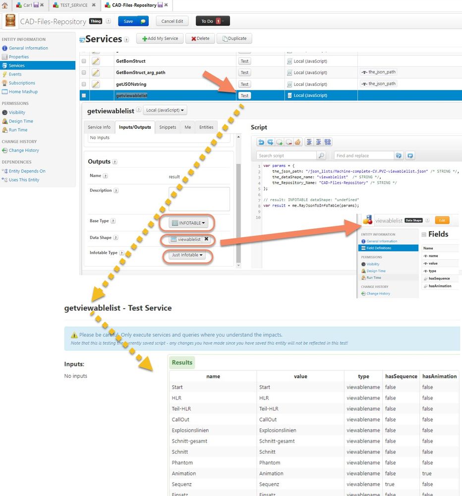

there is no extra format required. For example for the dataGrid your need a service which returns an InfoTable. You need to pay attention that the result is also defined with datashape - because without explicit datashape it will not see the header fields - this is also an issue for repeaters (actually the dataGrid is a kind of repeater)
So TWX Thing service e.g. getviewablelist which is defined as:

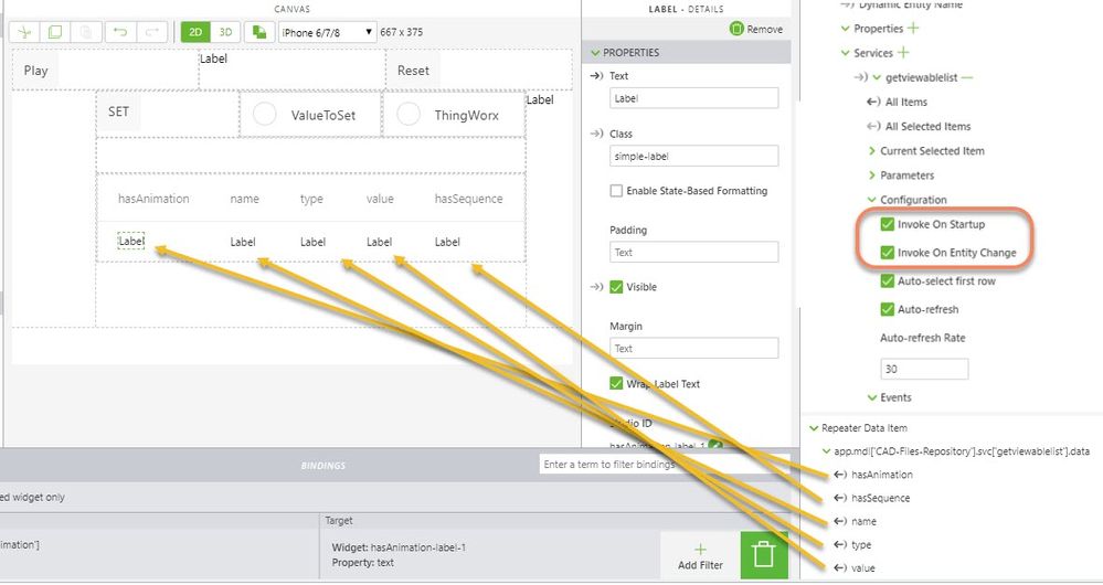

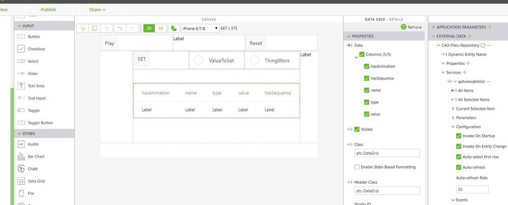

Next  in the external data we can add the service "getviewablelist" and create a binding between  service resutls -> all items  and the dataGrid - data property
The next step is to connect the fields of the DataGrid widget with the repeater entities comming from the service

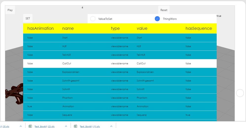

And now we can test it in the preview :
So in this example I used a css example style provided in the Studio Vuforia Help -> DataGrid

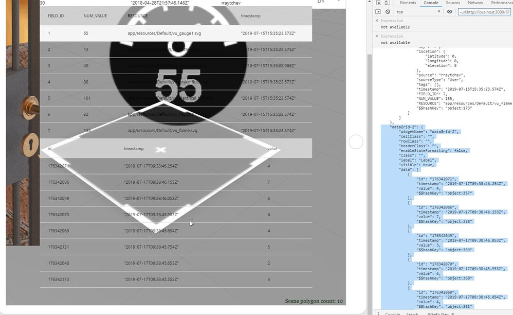

So, back to the question -  I need to check this more deeply if we can manage this anyways without thingworx. I do not think that we have any official documentation about the syntax.
Possible idea will be to check the Thingworx solution and try to extract the data and check the syntax on the chrome debugging console.
so printing the Grid properties I will get the following printing  of it to  the console for my sample solution form the previous post:

Here is relevant the data: filed in the json.
I think with can use this syntax without $$hashKey which is added later.
