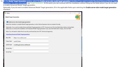

Hello everyone, I'm trying to publish a vuforia experience with model targeting but when I try to do so by pressing the publish button, it won't show the publish progress bar and, checking on the experience server, the project can't be found. By analyzing the log I found the following error:
[2025-02-13T08:34:44.475Z] error: [twx-studio:index] Server error dee60aaf-9b9c-4561-a021-65d4ee2bcf63 [Error: ENOENT: no such file or directory, stat 'C:\Users\<userName>\Documents\VuforiaStudio\Projects\<projectName>\dist\lib\cdn\angular-sanitize.min.js.map'] {
[2025-02-13T08:34:44.476Z] error: errno: -4058,
[2025-02-13T08:34:44.476Z] error: code: 'ENOENT',
[2025-02-13T08:34:44.476Z] error: syscall: 'stat',
[2025-02-13T08:34:44.476Z] error: path: 'C:\\Users\\<userName>\\Documents\\VuforiaStudio\\Projects\\<projectName>\\dist\\lib\\cdn\\angular-sanitize.min.js.map',
[2025-02-13T08:34:44.476Z] error: expose: false,
[2025-02-13T08:34:44.476Z] error: statusCode: 404,
[2025-02-13T08:34:44.476Z] error: status: 404
[2025-02-13T08:34:44.476Z] error: }
But, as soon as I remove the model target, I don't have any issues

Hello @FC_12202090 , I believe you have already opened a ticket with us.
Is your Experience Service (ES) running behind a proxy?
Would you please confirm whether the Model target generation is enabled at the Vuforia Experience Service side or not as shown in the screenshot?
Please refer to the Vuforia Experience Service help center link for more details--> https://support.ptc.com/help/vuforia/es_install/en/index.html#page/ES_Install_Help_Center%2FThingServerInstall_ESInstall_Windows.html%23wwID0ENCLO
